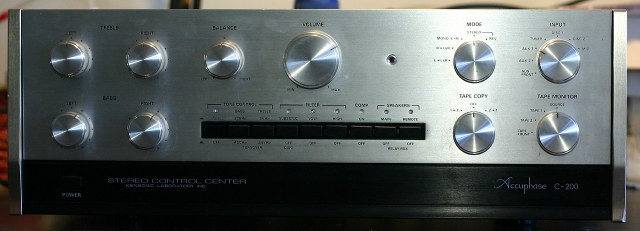

Exceptionally rare Accuphase C-200 preamp. WOW!
I've had to opportunity to to restore a very rare piece of equipment, an Accuphase C-200 preamplifier. When I was just a kid, Accuphase was stuff I could only dream about. Seriously top-tier for the period, and totally out of reach financially. But oh, do I remember these!
Well, I've had one cross my path after all these years and end up in the Pacific lab. Here she is, in a teaser shot. She's gorgeous.
Accuphase was imported and distributed by TEAC, but came from an outfit called Kensonic. Some of the boards inside this unit say "Kensonic" on them and others say "Accuphase." All the boards were made by Elna, very common at that time.
Here's are some preliminary looks. She's on the bench here, being evaluated.
While she works, she definitely has some serious problems. For one, the power switch is welded in the on position. Switches and controls are terribly noisy and intermittent. And the volume control is beyond awful. So... let's peel this onion away a little bit, shall we?
Yes, one of the secrets to noise performance is shield, shield, shield. And wow, do they! Here's a shot with those covers removed.
Wow! Now isn't this some beautiful construction? Each board plugs into a connector and is easily removed for service. This is just wonderful. Here's the bottom side of the unit:

Well, what could this be about? I expected to find clean, pristine boards under those covers, and instead I see this. There's certainly no evidence of water intrusion or anything else. What could this be? One of the things I notice about the boards is that the solder just looks very strange. They're not the standard smooth joints I expect to see. Rather, they look mottled and grainy. It looks like something I've seen when boards contain water and are wave-soldered. The water turns to steam, escapes and makes bubbles in the joints. This is a shot of a different board, but you'll see what I mean.
Not what you would expect, is it? And here's what the bottom of the phono board looks like:
EEEEK! Well, someone's been here before. And apparently, he didn't like the way the solder looked and he attempted a rework. But here's the bad news. There's something in these boards (water, or maybe some other unknown chemical) that makes gas when it's heated. And these joints are nearly impossible to make look smooth and ordinary. In the state they are in from the factory, they're actually fine from an electrical standpoint. They're just incredibly ugly. I wonder if there has been some interaction between whatever is in these boards and whatever flux was contained in the rework solder to have made those transistors corrode? Because these (there are two boards) are the only boards that were reworked like this, and these were the only ones to exhibit a corrosion problem to this extent.
But the problem doesn't extend just to those transistors. Oh, no. There's other problems because of it. Remember those Sony TO-66 transistors (about three photos up)? They connect to the board via the mounting screws. Those mounting screws are tightened and then soldered to the pads on the board. Well, they are SUPPOSED to be. These just unscrewed, like there was no solder there at all. And take a look at what I found when I removed the screws:
Saaaay WHAT? Look at those pads. Black oxide, with just a smidgeon of connectivity via the lockwashers. Whatever is in these boards is interacting with the copper, too. Oh, boy. So we have to clean those pads before we put the parts back on.
And what other troubles might be lurking on this board? Well, just about every other joint revealed black oxide on the copper when inspected and reworked. You can imagine how much fun (and work) that was.
Try as you might, you just can't make these joints look up to standard. But they have all been reworked and the board now looks good and works well. While I have both those Sony TO-66 parts and the other transistors too, they are exceptionally rare and expensive. Modern parts fit the bill nicely at a much lower cost. The Sony transistors don't need to be replaced, I just clean them up and replace the hardware.
Something I noticed was that some boards gassed more than others, and one didn't gas at all (that one happened to be the little fuse board on the bottom, a board I did not take a before and after of). I really wish I knew what was going on with the boards.
And what do we do now? Lather, rinse, repeat. There's another board just like this one. And it looks just like this one does. Ugh. In this case, I ended up reworking all of the joints that were reworked by someone else to be sure all was good and on the other boards left everything else alone. Moving on...
The power switch on this sample is welded in the ON position. The reason for this is not that this unit makes a huge inrush of current, but rather the corresponding Accuphase P-300 that's plugged into the back does. Take a look at this power switch arrangement.

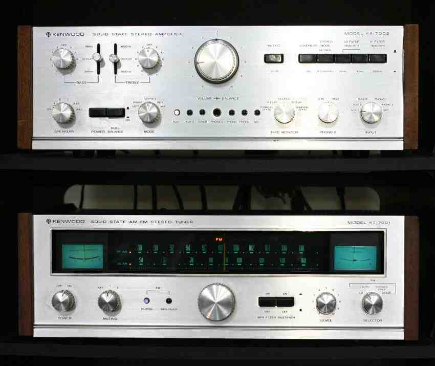

Kensonic who made Accuphase was started by an ex Kenwood engineer about that time and that explains some of the similarities:
http://en.wikipedia.org/wiki/Accuphase
I used to own this KA-7002 and its matching tuner also..
Dave
